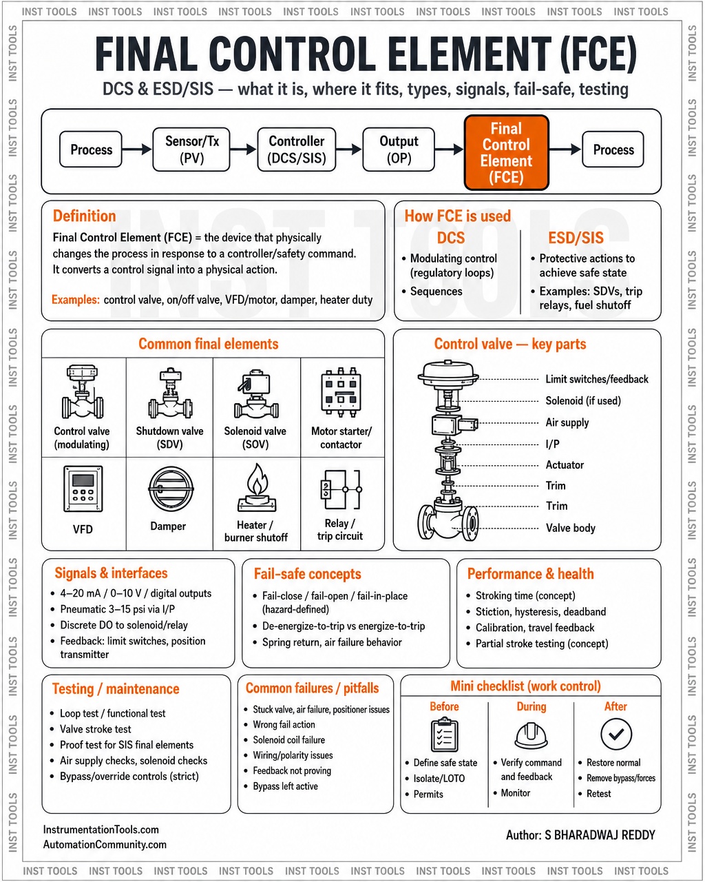

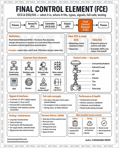

Final Control Element in Process Industries
A controller can calculate the perfect output—but the process won’t change unless something physically acts on the process.
:backhand_index_pointing_right: That device is called the Final Control Element (FCE).
:small_blue_diamond: What is a Final Control Element?
A Final Control Element is the device in a control loop that directly manipulates the process to change the controlled condition based on the controller’s output.
In simple terms:
:bullseye: Controller decides → FCE acts on the process
:factory: Typical Control Loop
Sensor → Transmitter → Controller → Final Control Element → Process
For example:
:thermometer: Temperature Sensor
:down_arrow:
:satellite_antenna: Temperature Transmitter
:down_arrow:
:brain: PID Controller
:down_arrow:
:control_knobs: Steam Control Valve
:down_arrow:
:fire: Process Temperature
Here:
:bullseye: Controlled Variable (CV) = Temperature
:control_knobs: Manipulated Variable (MV) = Steam flow
:wrench: Final Control Element (FCE) = Steam control valve
:wrench: Common Final Control Elements
:one: Control Valve :control_knobs:
The most common FCE in process industries.
Examples:
:droplet: Flow control valve
:fire: Steam control valve
:fuel_pump: Fuel gas control valve
:thermometer: Cooling-water valve
The controller changes the valve position to manipulate process flow.
:two: Variable Speed Drive (VFD) :gear:
A VFD can control motor speed.
For example:
Flow Controller → VFD → Pump Speed → Flow
Here, the VFD/motor-pump arrangement performs the final control action, depending on how the control loop is defined.
:three: Damper
Used in:
:wind_face: Airflow control
:fire: Combustion systems
:factory: HVAC systems
:four: Heater / Electrical Actuator :fire:
In temperature-control applications, the controller may regulate:
:high_voltage: Heater power
to change the process temperature.
:police_car_light: FCE in an ESD/SIS
In a safety system, the final element is the device that carries out the safety action when the SIF demands it.
Example:
Pressure Transmitters → Safety Logic Solver → Solenoid → Shutdown Valve
Here, the shutdown valve and its associated final-actuation components form the final element of the SIF, depending on the defined architecture and safety requirements.
:police_car_light: High pressure detected
:down_arrow:
:brain: SIS logic
:down_arrow:
:electric_plug: Solenoid de-energizes
:down_arrow:
:locked: Shutdown valve closes
:down_arrow:
:shield: Hazardous energy/process flow is isolated
:vs_button: Control Valve vs Final Control Element
A control valve is a type of final control element.
But:
Not every final control element is a control valve.
FCEs can include:
:control_knobs: Valves
:gear: Variable-speed drives
:wind_face: Dampers
:fire: Heaters
:electric_plug: Electrical actuators
The correct identification depends on what physically manipulates the process.
:bullseye: Interview Question
:backhand_index_pointing_right: A Final Control Element is the device that receives the controller’s output and directly changes a process variable by manipulating the process.
:light_bulb: Remember:
:brain: Controller = Decides
:control_knobs: FCE = Acts
:factory: Process = Changes
The controller tells the process what to do. The final control element actually does it. :gear::bullseye:
