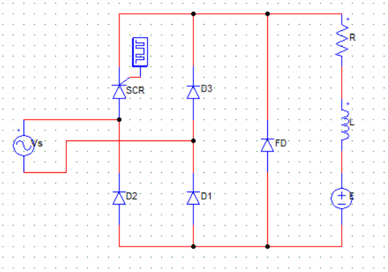

Find the value of the power delivered to the voltage source ___
In the below given circuit, the average value of output voltage is 191 V.
Find the value of the power delivered to the voltage source E.
Load Current is Continous
Take E = 100 V and R = 5 Ω.
Assume that the load current is continuous.
A. 1.82 kW
B. 18.2 kW
C. 0.182 kW
D. 18.2 W
Answer: A
