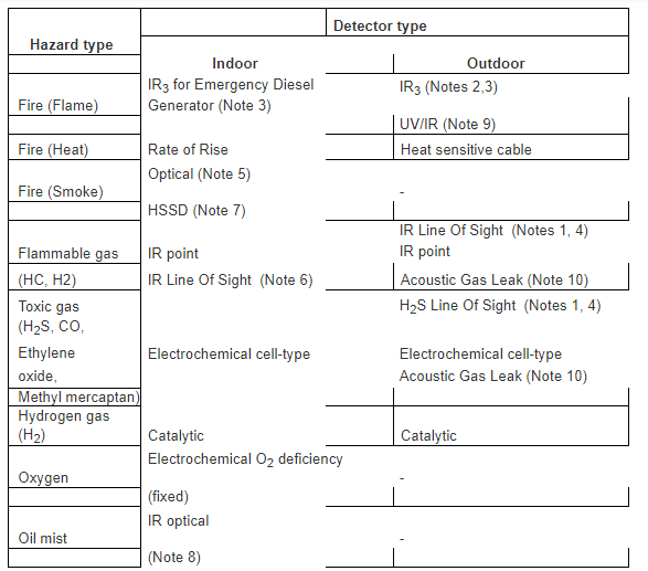

Type of Detectors / Selection of Detectors
Notes:
Line Of Sight IR detector technology provides greater coverage than point detector for detection (of flammable and toxic) and thus suggested to be used wherever practicable for detecting gas accumulation or gas cloud migration in open facilities. If necessary additional points detectors can be considerd.
IR3 flame detectors can be protected from tropical environmental conditions (rains, humidity, solar radiations) by the following means:
Orientation of the detectors towards the ground floor to limit their exposition to the rains: they shall be oriented at an angle of pitch between 5 and 40 degrees below horizontal, so as to promote natural drainage of any condensed water or rain and to reduce accumulation of dust or debris;
Protection of the detectors by a rain covers or weather protection;
Heating of the sensor’s optic to facilitate the evaporation of the condensation.
IR3 and UV/IR flame detectors must have a cone of vision of at least 90° in horizontal and 90° in vertical.
Particular attention shall be taken during installation of supports of Line Of Sight detectors to limit the loss of signal between the transmitter and the receptor.
It is suggested that in air ducts to have air speeds above 5 m/s, windshields to be provided.
Where air intakes are greater than 1. 5 x 1.5m, Line Of Sight gas detectors are preferred.
Use of High Sensitivity Smoke Detector is for Field Auxiliary Rooms, CTRs, UPS, TER (administrative buildings).
Due to relatively high sensitivity, IR optical oil mist detectors can be used to alert operators to a potential incident rather than as a sole means of initiation shutdown or other control actions. If not properly installed and maintained, they will be less reliable and could give high unwanted alarm rates. They shall be considered for Emergency Diesel Generator and other enclosed equipment able to generate oil mists. Particular attention regarding the environmental conditions as the sensor is not suitable for ambient temperatures above 75°C.
Use of UV/IR flame detectors is required for hydrogen fire detection.
Acoustic gas leak detectors may be used in process units handling gas at high pressure (above 10 barg) where other detectors are not suitable. Voting with other technologies (point and/or LOS) could be performed for alarming purposes.
