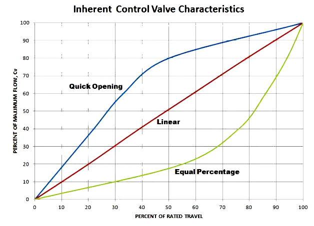

The three most common types of flow characteristics are:
- Linear
- Equal percentage
- Quick opening
Linear valve characteristics
This characteristic provides a linear relationship between the valve position and the flow rate.
The flow through a linear valve varies directly with the position of the valve stem.
This flow travel relationship, if plotted on rectilinear coordinates, approximates a straight line, thereby giving equal volume changes for equal lift changes regardless of percent of valve opening.
These valves are often used for liquid level control and certain flow control operations requiring constant gain.
Equal percentage valve characteristics
The equal percentage valve plug produces the same percentage change in flow per fixed increment of valve stroke at any location on its characteristic curve.
For example, if 30% stem lift produces 5 gpm and a lift increase of 10% to 40% produces 8 gpm or a 60% increase over the previous 5 gpm, then a further stroke of 10% now produces a 60% increase over the previous 8 gpm for a total flow of 12.8 gpm.
These types of valves are commonly used for pressure control applications and are most suitable for applications where a high variation in pressure drop is expected.
Quick opening valve characteristics
A quick opening valve plug produces a large increase in flow for a small initial change in stem travel. Near maximum flow is reached at a relatively low percentage of maximum stem lift.
Quick opening plugs are normally utilized in two position - applications but may be used in some linear valve applications. This is possible because of its initial linear characteristic at a low percentage of stem travel.
The slope of this linear region is very steep which produces a higher initial gain than the linear plug but also increases the potential instability of the control valve.
Inherent valve characteristics
An inherent flow characteristic is the relation between valve opening and flow under constant pressure conditions.
The inherent characteristic of a valve is obtained when there is a constant pressure drop across the valve for all valve positions; the process fluid is not flashing, cavitating or approaching sonic velocity (choked flow); and the actuator is linear (valve stem travel is proportional to the controller output).
Some valves have inherent characteristics that cannot be changed, such as full port ball valves and butterfly valves. For other valve types, such as the globe type, the inherent characteristics can be changed to suit the application.
