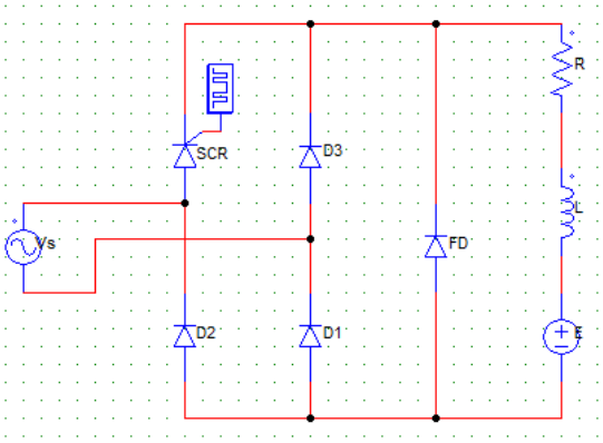

For the below given circuit configuration, the SCR is fired at ___
For the below given circuit configuration, the SCR is fired at angle α.
Continous Current Mode
For continuous current mode from ωt = π to 2π
A. FD conducts
B. SCR and D1 conduct
C. D3 and D2 conducts
D. None of the mentioned
Answer: C
