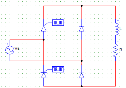

For the circuit shown below, T1 and T2 (from top T1 and T2) are both fired at an angle α.
Then from ωt = π to ωt = π+α
A. None of the devices conduct
B. T1 and one diode will conduct
C. T2 and one diode will conduct
D. Both the diodes will conduct
Answer: D
