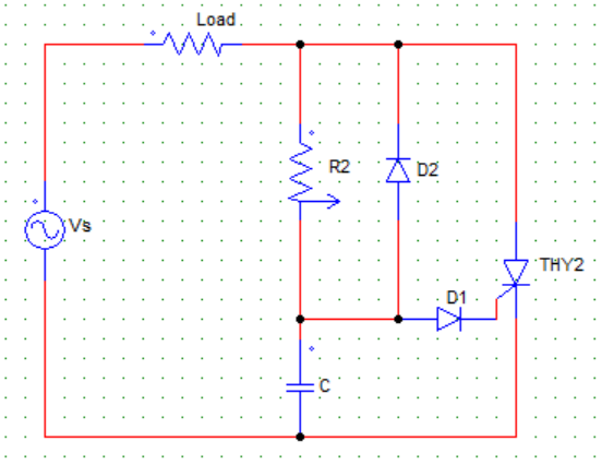

For the following RC triggering circuit with R load and ___
For the following RC triggering circuit with R load and a firing angle of α, the voltage across the R load is zero for
RC Triggering Circuit
A. ωt = 0 to α and ωt = π to 2π+α
B. ωt = 0 to α
C. ωt = π to 2π+α
D. ωt = α to 2π
Answer: A
