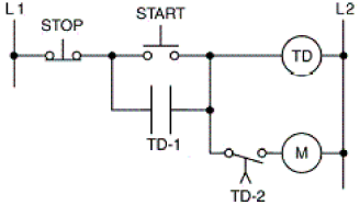

For the hardwired timer circuit shown, contact TD-1 is ___
For the hardwired timer circuit shown, contact TD-1 is the ____ contact and TD-2 is the ____ contact.
Hardwired Timer
A. ON, OFF
B. OFF, ON
C. instantaneous, timed
D. timed, instantaneous
Answer: C
