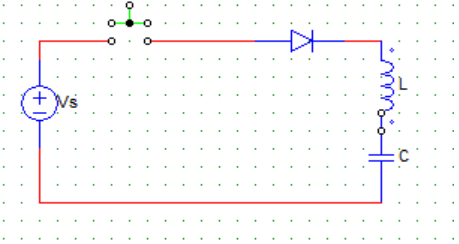

For the initially relaxed circuit shown below, the Laplace transform of ___
For the initially relaxed circuit shown below, the Laplace transform of the KVL when the switch is closed is
I(s) [ X ] = Vs/s
The value of X is
2.Relaxed Circuit
A. sL + 1/C
B. Cs + 1/sL
C. sL + 1/sC
D. Vs/CLs
Answer: C
