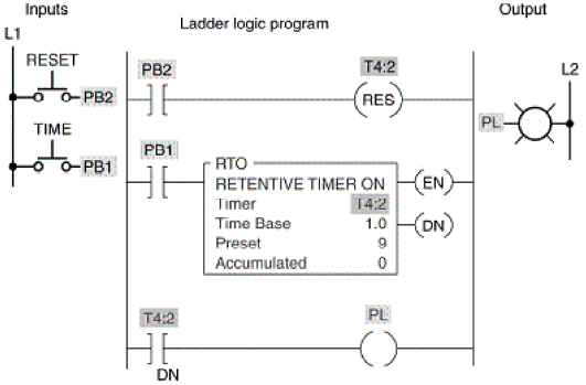

For the program shown, the timer accumulated time is set to zero anytime:
A. PB1 is closed.
B. PB2 is closed.
C. PB1 is open.
D. PB2 is open.
Answer: B
A. PB1 is closed.
B. PB2 is closed.
C. PB1 is open.
D. PB2 is open.
Answer: B
