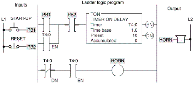

For the programmed timer circuit shown, the ____ bit of the timer functions similar to a timed contact.
A. DN
B. EN
C. PB1
D. PB2
Answer: A
