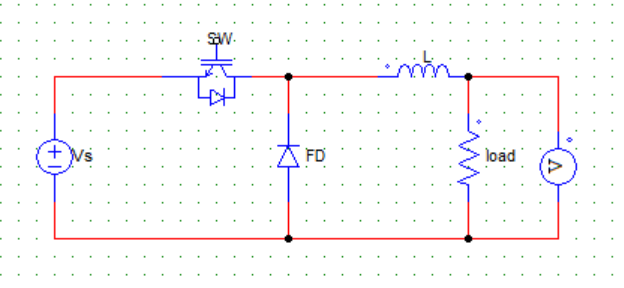

For the step-down chopper shown in the figure below, dc source voltage = 230 V.
Find the power delivered to the load of R = 10 Ω.
Duty cycle = 40 %.
Take voltage drop at the switch to be 2 V.
A. 1 kW
B. 2.08 kW
C. 569 W
D. 207 W
Answer: B
