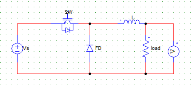

For the step-down chopper shown in the figure below, dc source voltage = 230 V and the voltage drop across the chopper = 2 V.
Find the value of rms output voltage for a duty cycle of 0.4.
A. 91.2 V
B. 230 V
C. 144.2 V
D. 145 V
Answer: C
