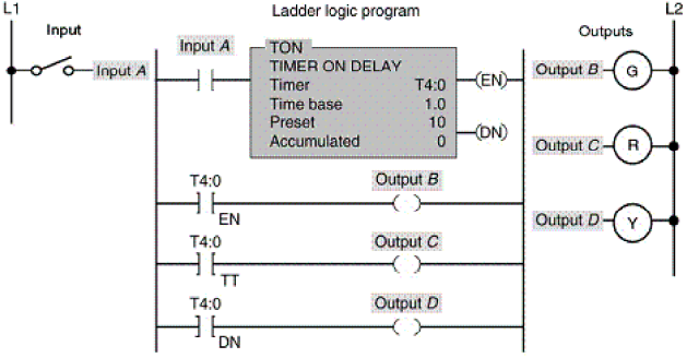

For the timer circuit shown, the timer accumulated value will reset to zero whenever:
Timer Circuit
A. input A switch is opened.
B. input A switch is closed.
C. the DN bit is set to 1.
D. the EN bit is set to 1.
Answer: A
