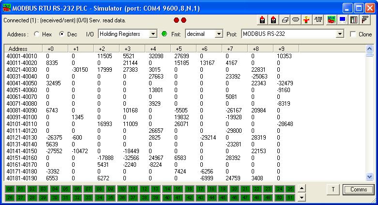

The main program window in Modbus RTU mode
  1. Download the simulator.
  2. Run it, and select TCP/IP or serial protocol.
  3. If you want serial, you can try using com0com (see the links page) to create a local loopback, and skip the serial cable.
  4. Select your serial port from the settings dialog (or if TCP/IP, simply point your HMI/SCADA to the local IP address) and connect.
  5. Next you can click on the “Comms” button in the bottom-right to see the state of the communication link to see if your master is trying to connect and talk to the simulator already.
  6. Now go and look at your SCADA/HMI, if it’s not already talking, go into your ‘drivers’ and make sure they are started (in most cases no license will be needed from modbus protocol in your SCADA simply because it is so popular for verification), and if still not talking, look at your own communication logs.
  7. Unless you are doing something wrong, you should have zeroed raw values visible in the SCADA/HMI. Basically all SCADA analogs and digitals will be zeroed, or in the case of a 4-20mA, will be out-of range. Now for some fun read the User Documentation.

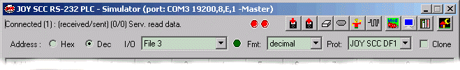

  • Screenshot showing Allen-Bradley MASTER ‘JOY SSC DF1’ protocol emulating a continuous coal miner. Selecting a different protocol opens up new options for setting up each protocol as relevant.
The simulator in the JOY machine mode using Allen-Bradley DF1 protocol
