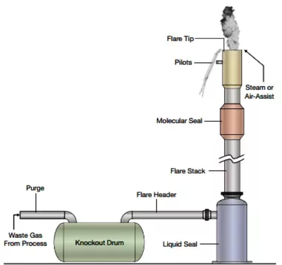

Gas Flare System Working :- When industrial plant equipment items are over-pressured, the pressure relief valve is an essential safety device that automatically release gases and sometimes liquids.
A gas flare, instead called a flare stack, could be a gas combustion device utilized in industrial plants like oil refineries, chemical plants, and gas process plants likewise as at oil or gas production sites having oil wells, gas wells, offshore oil and gas rigs and landfills.
In industrial plants, flare stacks is a primarily used for burning off combustible gas discharged by pressure relief valves throughout unplanned over-pressuring of plant equipment. Throughout plant or partial plant startups and shutdowns, flare stacks also are typically used for the planned combustion of gases over comparatively short periods.
