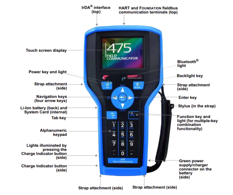

The configuration or calibration can be made by programs installed on the workstations of the control network, these programs allow the communication between the HART device and the system. Also, you can use a HART handheld or HART field communicator to calibrate or configure the device.
You can connect the HART communicators anywhere in the loop, the only requirement is the minimum resistance of 250Ω in parallel to the communicator.
