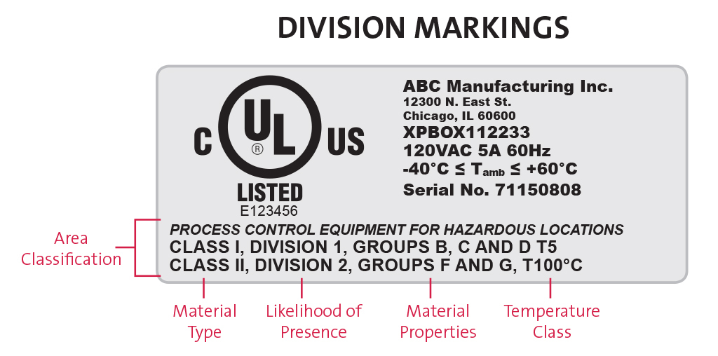

DIVISION SYSTEM (NEC ARTICLE 500 THROUGH 503/CEC SECTION 18)
Sample Marking:
Divisions
- Division 1 β Ignitable concentrations of flammable gases, flammable liquid-produced vapors, or combustible liquid-produces vapors can exist under normal operating conditions.
- Division 2 β Ignitable concentrations of flammable gases, flammable liquid-produced vapors, or combustible liquid-produces vapors are not likely to exist under normal operating conditions.
Class β Materials are divided by type:
- Class I β Flammable gases, flammable liquid produced vapors, and combustible liquid produced vapors
- Class II β Combustible dusts
- Class III β Ignitable fibers / flyings
Groups β Materials are further divided into Groups for Class I, Divisions 1 and 2:
- A β Acetylene
- B β Hydrogen
- C β Ethylene
- D β Propane
Groups β Materials are further divided into Groups for Class II, Division 1 and 2:
- E β Metal Dusts (Div. 1 only)
- F β Carbonaceous Dusts
- G β Non-Conductive Dusts (flour, grain, wood, plastic, etc.)

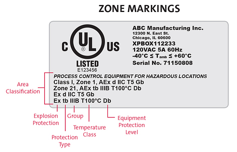

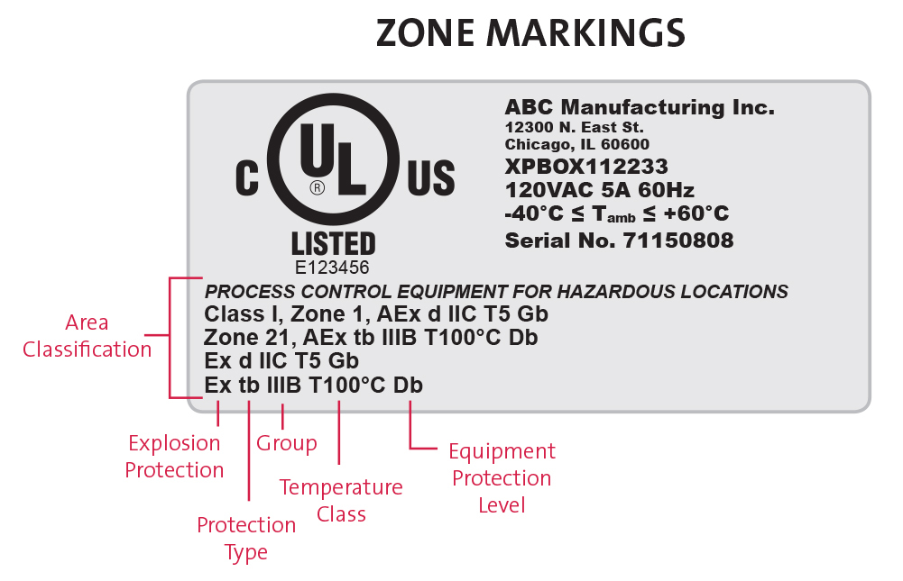

ZONE SYSTEM (NEC ARTICLE 505-506 / CEC SECTION 18)
Sample Marking:
Zones
- Zone 0 β Ignitable concentrations of flammable gases, flammable liquid-produced vapors, or combustible liquid-produces vapors are present continuously or for long periods of time under normal operating conditions.
- Zone 1 β Ignitable concentrations of flammable gases, flammable liquid-produced vapors, or combustible liquid-produces vapors are likely to exist under normal operating conditions.
- Zone 2 β Ignitable concentrations of flammable gases, flammable liquid-produced vapors, or combustible liquid-produces vapors are not likely to exist under normal operating conditions.
- Zone 20 β Ignitable concentrations of combustible dust or ignitable fibers/flyings are present continuously or for long periods of time under normal operating conditions.
- Zone 21 β Ignitable concentrations of combustible dust or ignitable fibers/flyings are likely to exist occasionally under normal operating conditions.
- Zone 22 β Ignitable concentrations of combustible dust or ignitable fibers/flyings are not likely to occur under normal operating conditions.
Groups β Class I, Zone 0, 1, and 2
- IIC β Acetylene & Hydrogen
- IIB + H2 β Hydrogen
- IIB β Ethylene
- IIA β Propane
Groups β Zone 20, 21, and 22
- IIIC β Conductive Dust
- IIIB β Non-Conductive Dust
- IIIA β Combustible Flyings
