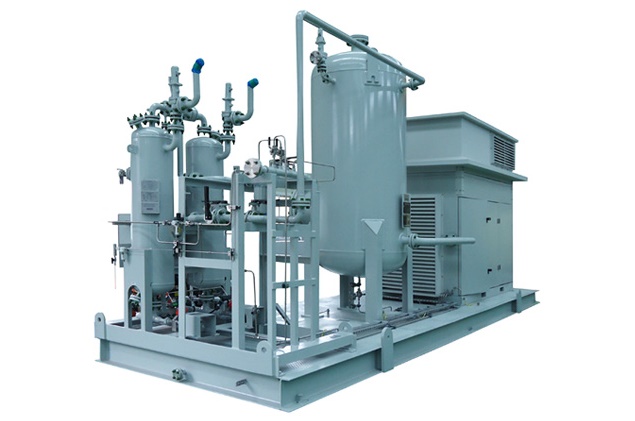

Instrument air consumption shall be calculated during detail design to determine the plant utility air requirement by pneumatic operated instrument as well as package which requires air for its utility such as purging or other purpose.
Instrument air consumption calculation will be the basis to size instrument air utility system which consists of air compressor, air drier, and air receiver.
Actuated valve such as shutdown valve, blowdown valve and control valve are instruments which require instrument air for their operation. Instrument air requirement of each instrument valves depends on its actuator size and its operation.
