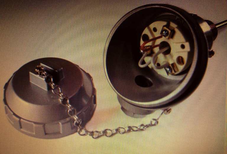

There are three wires in RTD. Out of the two wires are short-circuited as shown in the figure. Same color wires are short-circuited.
white color wires are short-circuited
Resistance Temperature Detector
Step 1
We will check whether two same color wires are short-circuited or not. If no then connect a wire between these two same color wires. This wire can be connected either on RTD Side or Indicator Side.
Step 2
We will check whether the different color wire is showing the same resistance with the same color wires. If no then change the RTD.
Step 3
If different color wires are showing the same resistance then we will calculate the temperature according to the table or formula provided.

that means we will check the resistance between a white and red wire, it will show some value more than 100 ohms, this resistance is called as Rt.
suppose Rt is 138.5,
then t= (138.5-100)*2.6
approximately 100 degrees Celsius.
