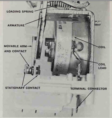

This photograph illustrates the major components of a relay. Two separate electrical tests are involved in testing the relay.
First, the coil is tested for continuity. The coil on a miniature relay such as this one is composed of thousands of turns of wire no larger in diameter than a human hair. One of the electrical leads from the coil can be seen attached to the right front terminal in the photo. With the test meter set on R x 1000 (the small wire has fairly high resistance) and probes touched to the two coil leads, this section of the relay can be tested.
second The contact section is tested like a switch. This relay is closed to one side while open to the other. When it moves to the opposite position as the coil is energized and pulls the armature in by electromagnetic force, the side which is now closed will be open and vice-versa. This is called a single-pole, double-throw switching arrangement (SPDT).
