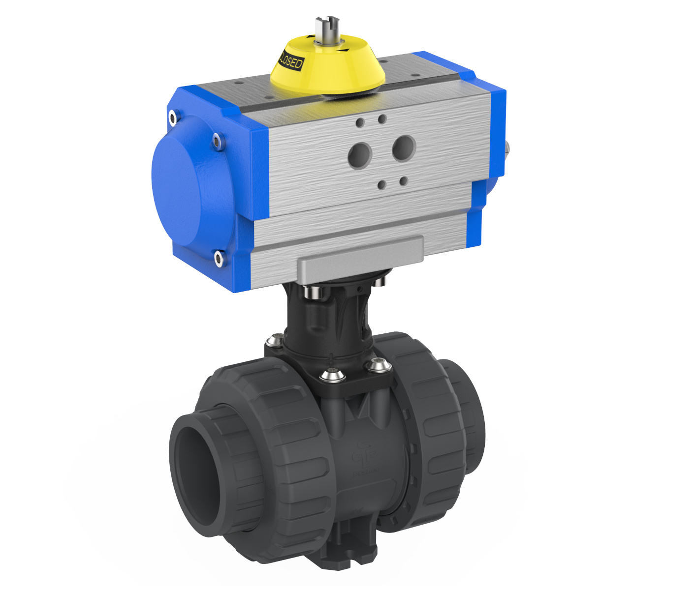

Valve Actuator based on the power source, falls into the three categories. Each power source of valve actuator has unique characteristic which provide different advantage to make it suitable for specific application.
1. Pneumatic Actuator
Pneumatic actuator is the most commonly used type due to the cheapest price and availability of its power source i.e. compressed air.
The use of natural gas is also applicable if it is not feasible to install air compressor system. It is used both for control valve which operates in throttling mode or actuated valve which intermittently operates.
