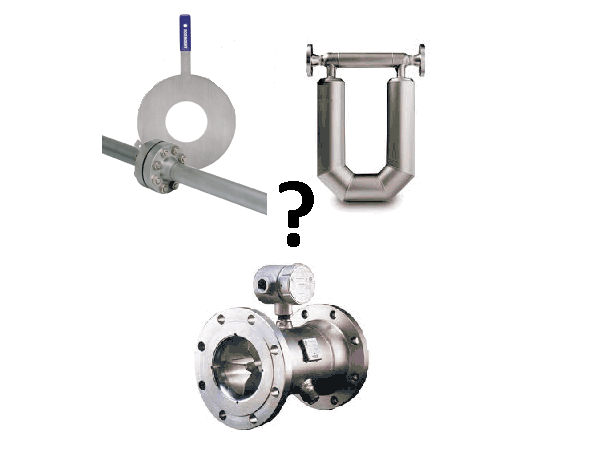

When it has been decided that instrument is required to be installed for specific service, the next job is to select to most suitable instrument type.
The following are several factors that should be considered when choosing the right instrument:
Process condition and properties
The fluid phase is the first thing to concern: gas, liquid or two-phase . Some type instruments are only suitable for particular phase while some others works properly on all kind of fluid phase.
Selected instrument shall also withstand to pressure and tempeture operating of proces fluid.
The process condition of fluid whether clean, dirty or containing slurries will also limit the instrument type selection. In addtion, corrosiveness of fluid will determine the selection of its material.
Range of process variable to be measured shall be specified. The wide range will require instrument type which has high turn down ratio, it means some type of instrument which has low turn down ratio will not be applicable.
Some instrument type is not designed for high viscosity services. Turbine meter will not work properly in high viscosity liqud, the float of magnetic level gauge might stuck and not floating to follow the level interface change.
Other properties such as reynold number shall be satisfied to particular number for some type of flow instrumentation.
Performance requirements
Each Instrument has static and dynamic characteristics . Accuracy, repeatability and linearity are some of characteristic that mostly being concern. The selection of instrument based on performance requirement is depend on the purpose of the instrument whether is it for process monitor, process control, safety, inventory measurment or custody transfer metering.

Space usually becomes an issue especially in offshore platform. For exampel, the issue in flow measurment is that some type of instrument requires straight run .

For flow measurement, DP type flow meter creates process cost (pressure loss). If the pressure outlet of the system is lower than the requirement, it needs more compression or pumping system which will significantly increase the budget.
