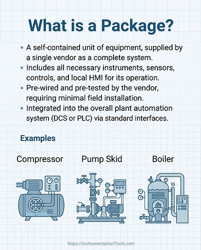

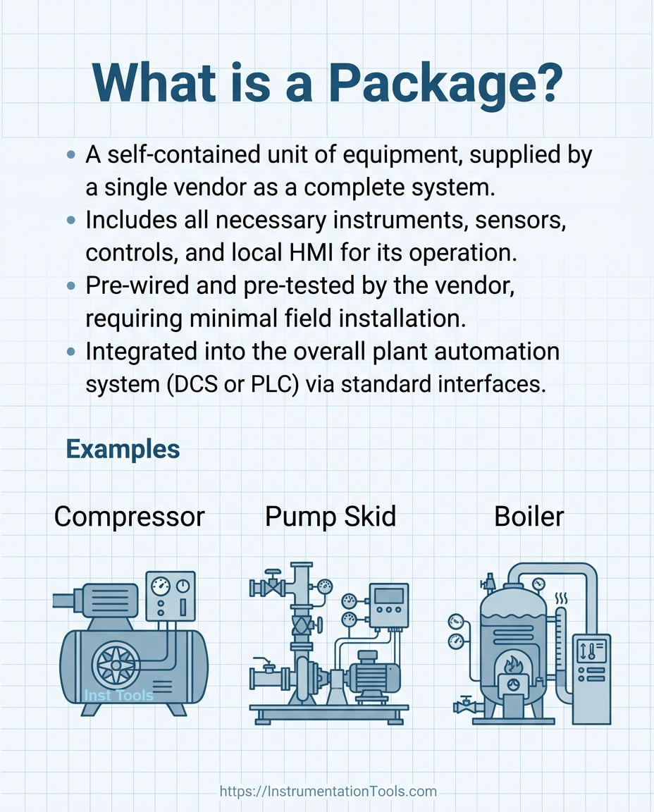

In detail engineering, an I&C project package is basically:
A piece of equipment (often skid-mounted) :package: + all its instruments :control_knobs: and control logic :brain: that come as one “mini-system” from a vendor.
Examples: compressor packages :cyclone:, pump skids :potable_water:, boilers :fire:, water treatment units :droplet:, etc.
Most of these packages originate in other disciplines (Process :test_tube:, Mechanical :wrench:, Electrical :high_voltage:).
But they still need I&C input for:
:control_knobs: Control philosophy
:pager: Instrument selection and ranges
:desktop_computer: Signals to DCS/PLC and safety systems :shield:

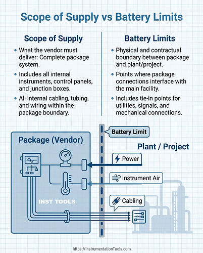

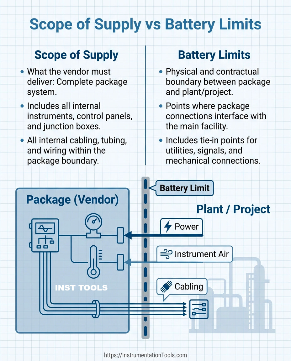

Why it matters: INTERFACES. :link:
If we don’t define who does what, gaps show up during installation :wrench: or commissioning :rocket:.
That’s where “battery limits” :battery: and “scope of supply” :package: come in:
:package: Scope of supply = what the vendor must deliver (instruments :control_knobs:, junction box :package:, local panel :desktop_computer:, cables :electric_plug: on skid…)
:battery: Battery limits = the physical boundary of that scope. Inside: vendor’s responsibility. Outside: project’s responsibility (power :high_voltage:, instrument air :dashing_away:, cables :electric_plug: to main panels, etc.).

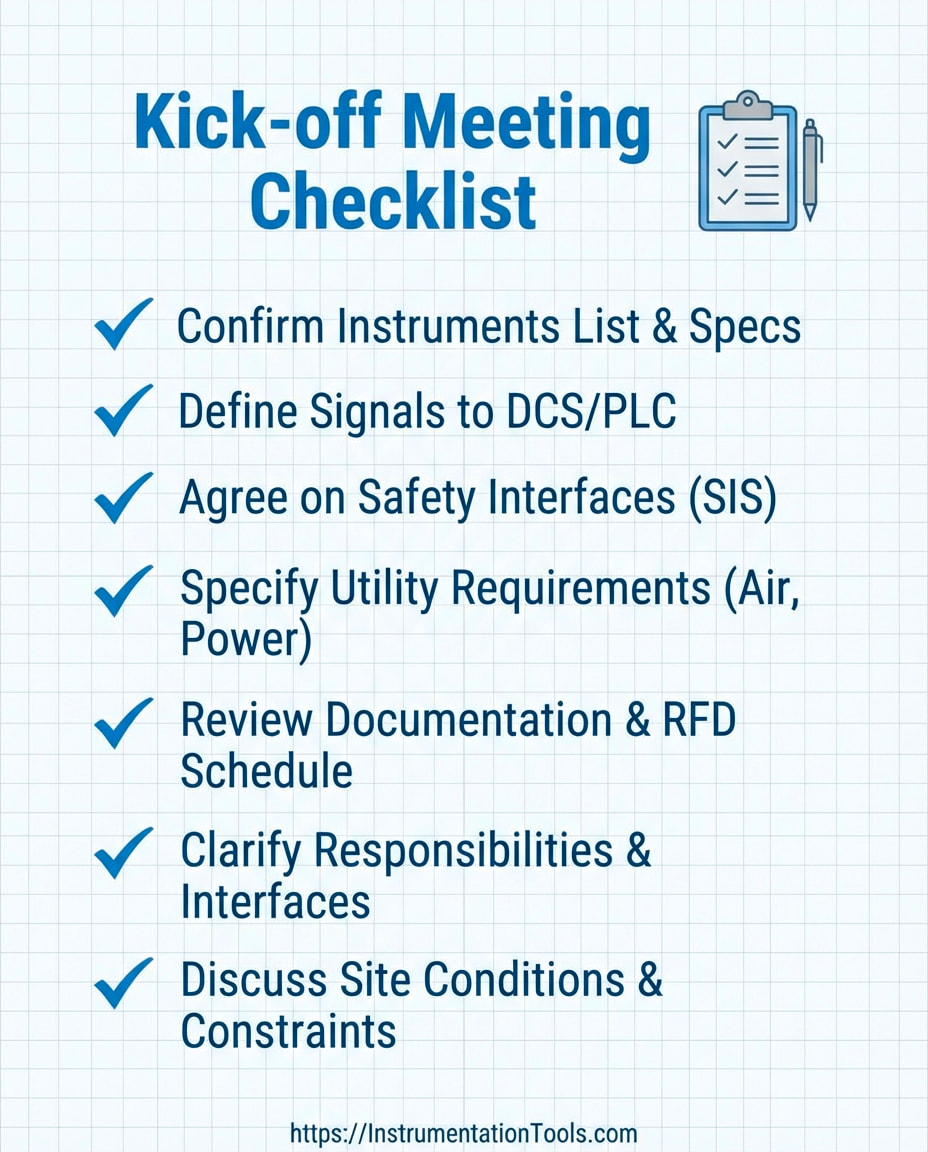

For beginners, a quick checklist to clarify early with the vendor:
:magnifying_glass_tilted_right: Which instruments :control_knobs: are in the package? Which are by others?
:straight_ruler: Where are the battery limits :battery: for cables :electric_plug:, tubing :fire_extinguisher:, power :high_voltage:, air :dashing_away:, signals :satellite_antenna:?
:desktop_computer: What signals go to DCS/PLC and to safety (ESD/PSD) systems :shield:?
:gear: Who provides and programs the local control panel/PLC :desktop_computer:?
