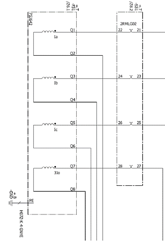

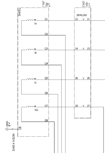

if I want to Test A phase to Ground fault, from which points of test block we will inject pick up current?
A. 22 & 28 B. 22 & 26 C. 22 & 24 D. 21 & 22
Answer: A
