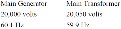

Just before the breaker was closed, the following parameter values existed:
Main generator , Transformer-PG-68
With no additional operator action, the main generator stabilized with the following parameter values:
25 MW
15 MVAR (in)

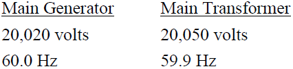

Now consider this following alternate set of parameters values:
Main generator , Transformer-PG-68-2
If the alternate set of parameter values had existed just before the breaker was closed, the resulting main generator MW value would have been __________; and the resulting main generator MVAR (in) value would have been __________.
A. larger; larger
B. larger; smaller
C. smaller; larger
D. smaller; smaller
Answer: D
