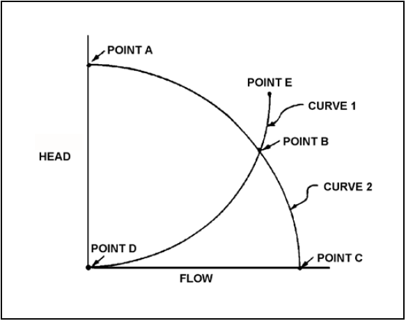

If the pump speed is reduced by one-half, the new operating point will be located on curve ___ closer to point ___
Refer to the drawing of centrifugal pump and system operating curves (see figure below).
centrifugal pump and system operating curves -PG-90
A centrifugal pump is initially operating at point B.
If the pump speed is reduced by one-half, the new operating point will be located on curve _____ closer to point _____.
A. 1; D
B. 2; A
C. 1; E
D. 2; C
Answer: A
