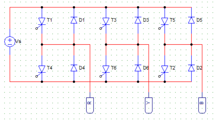

If the SCR T1 is gated at 0°, then for 120° mode of operation, from ωt = 240° to 300° __________ devices would conduct.
A. T3, T4
B. T4, T5
C. T1, T6
D. T5, T6
Answer: B
