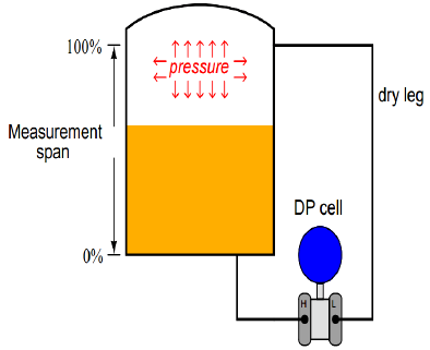

If the specific gravity of the liquid inside the vessel increases, what aspects of the transmitter’s calibration will we need to change in order to maintain accurate liquid level measurement?
A. We will need to change the transmitter’s LRV and linearity
B. We will need to change the transmitter’s linearity and span
C. We will need to change the transmitter’s LRV and URV
D. We will need to change the transmitter’s linearity and zero
E. We will need to change the transmitter from linear to square-root characterization, and adjust the zero
Answer: C
