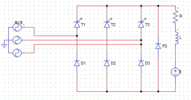

In a three-phase semi-converter, at a time one SCR and one diode conduct simultaneously.
With SCR T1 conducting which diode(s) is most likely to conduct along with T1?
A. D2 only
B. D3 only
C. D1 and D2
D. D2 and D3
Answer: D
