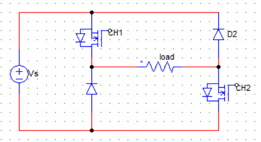

In the below given circuit, if Vo = -Vs then
A. both the chopper switches are on
B. only SW2 and D1 is active
C. both the chopper switches are off and both the diodes D1 and D2 are active
D. both the chopper switches are on and both the diodes D1 and D2 are reversed biased
Answer: C
