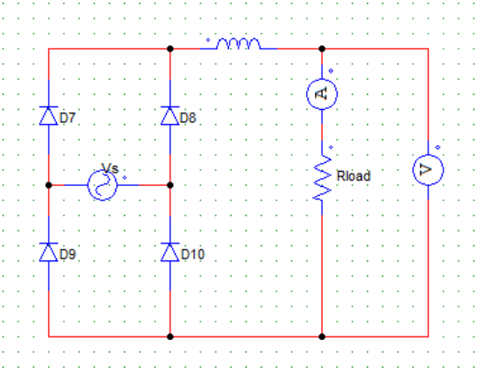

In the below given configuration, L is connected as a filter across the R load.
The average ammeter current is
A. 2Vm/R
B. 2Vm/πR
C. Vm/πR
D. Vm/R
Answer: B
