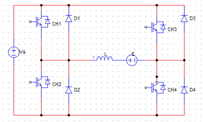

In the below given type E chopper circuit, when CH3 and CH2 are switched on and then CH3 is switched off after some time, then
A. load current falls to zero
B. negative current freewheels through CH2, D4
C. positive current freewheels through CH2, D4
D. none of the mentioned
Answer: B
