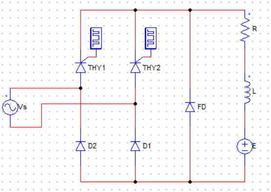

In the below shown semi-converter circuit T1 & T2 are fired at an angle α, then from ωt = π to α+π
A. T1 is conducting
B. T2 is conducting
C. D1 is conducting
D. FD conducting
Answer: D
