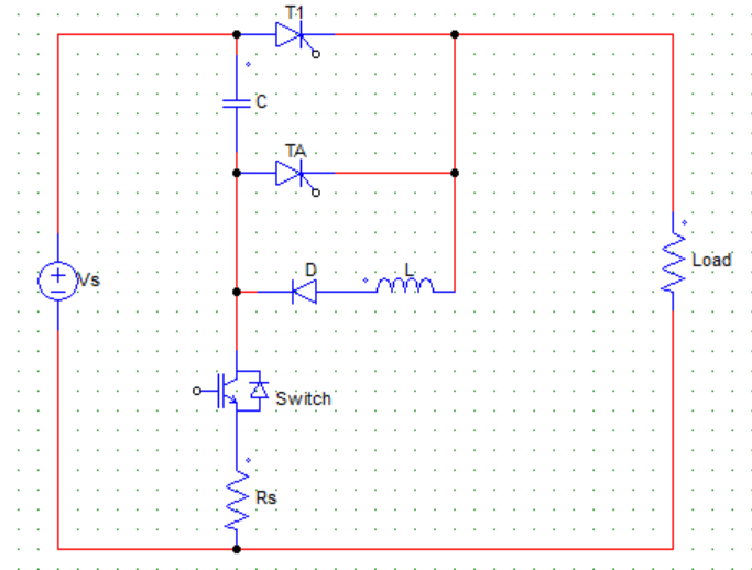

In the below shown voltage commutated chopper circuit, the chopper operation can only start when
A. t1 is gated
B. the capacitor is charged
C. the diode is forward biased
D. the capacitor is dis-charged
Answer: B
