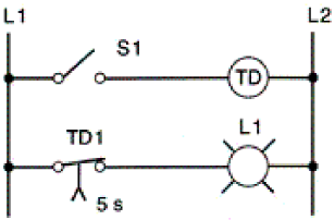

In the hardwired circuit shown, the light will stay on:
A. as long as S1 is closed.
B. for 5 s after coil TD is energized.
C. for 5 s after coil TD is de-energized.
D. both A and C.
Answer: B
