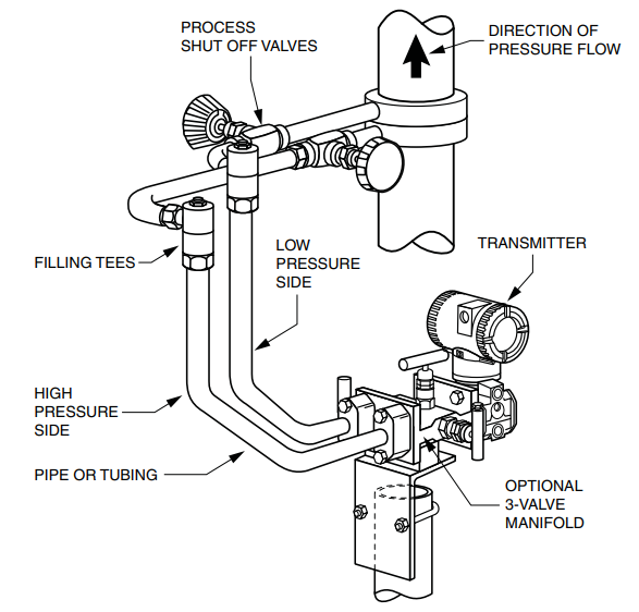

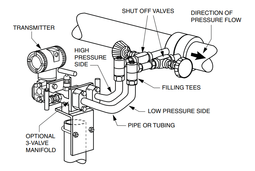

The below figures show typical installations with horizontal and vertical process pipes for flow transmitter.
The transmitters are shown below the level of the pressure connections at the pipe (usual arrangement, except for gas flow without a seal liquid), and with filling tees in the lines to the transmitter (for a seal liquid).
If the process fluid being measured must not come in contact with the transmitter, the transmitter lines must be filled with a suitable seal liquid (see procedure in next section). In such a case, the transmitter must be mounted below the level of the pressure connections at the pipe. With steam flow, the lines are filled with water to protect the transmitter from the hot steam.
The seal liquid (or water) is added to the lines through the filling tees. To prevent unequal heads on the transmitter, the tees must be at the same elevation and the transmitter must be mounted vertically (as shown). If a seal liquid is not required, elbows can be used in place of the tees.
Tighten drain plugs and optional vent screws to 20 Nâ‹…m (15 lbâ‹…ft).
Tighten the four process connector bolts to a torque of 61 Nâ‹…m (45 lbâ‹…ft). Note that the low and high pressure sides of the transmitter are identified by an L-H marking on the side of the sensor above the warning label.
With medium viscosity seal liquids and/or long transmitter lines, larger valve sizes should be used.
Example of Horizontal Process Line Installation
Example of Vertical Process Line Installation
Filling System with Seal Liquid
