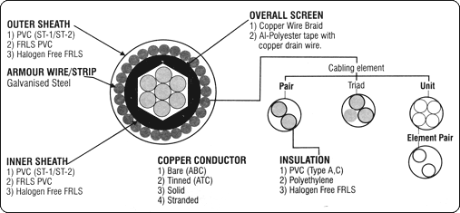

INSTRUMENTATION SIGNAL CABLES
Instrumentation Cables are specially designed to transmit signals without any external interference. They are used in Data Acquisition Systems, connections to Instruments, Computer Networking, PA Systems, Digital / Analog Control / Measuring & Communication Systems.
Construction - Cores, pairs, triads or quads
Voltage Grade - Up to 1100 V
Conductor - Electrolytic grade copper Bare / Tinned Solid / Stranded/Flexible conductors
Range - 0.5 / 0.75 / 1.0 / 1.5 / 2.5 Sq mm up to 48 Pair
Primary Insulation - General purpose PVC / Heat Resistant PVC / LDPE / XLPE / PTFE / Fibre Glass /
FEP / Silicone Rubber
Screening - Individual and/or overall with following options - Aluminum Mylar/Copper Tape with Tinned Copper Drain Wire or Braided with Bare or Tinned or Nickel Plated or Silver Plated Copper
Inner Sheath - PVC / HRPVC / FRPVC / FRLS PVC / ZHFR / LSF
Armouring - GI round Wire / Flat strip or Wire Braiding
Outer Sheath - PVC / HRPVC / FRPVC / FRLS PVC / ZHFR / LSF
Rip Cord - For easy removal of sheath
Standards - BS-5308 Part-1 & 2, BS-7655, IEC-189 (1 & 2), VDE-0815 & 0816 and BS EN 50288
Additional Features - Communication pairs, Bi-colour extrusion
