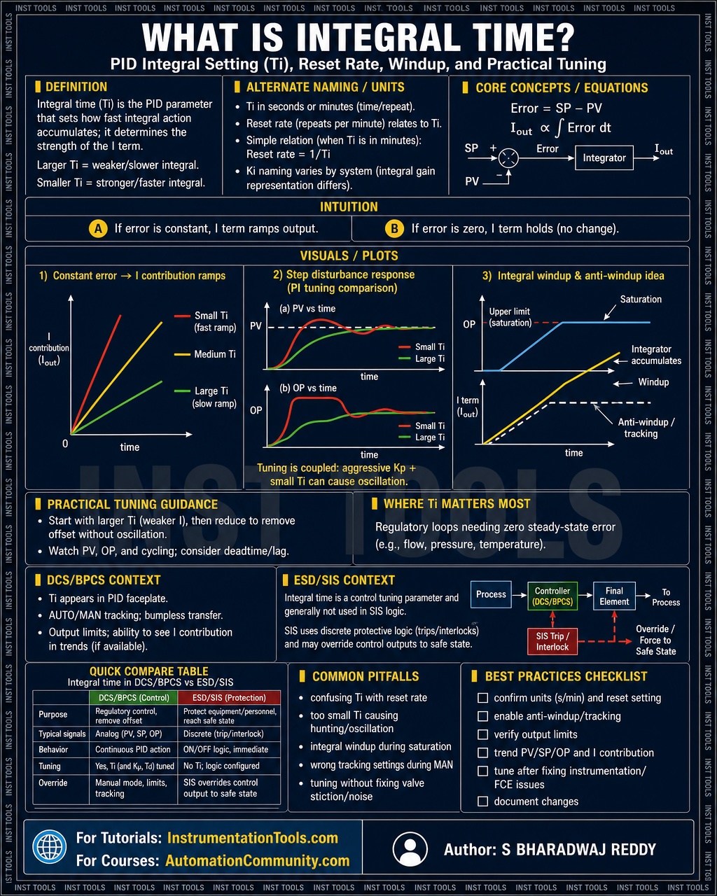

Integral Time (Ti)
:stopwatch::control_knobs: INTEGRAL TIME (Ti): How Quickly the Integral Action Acts! :gear:
In a PID controller, Integral Time (Ti) is a key tuning parameter that determines the strength of the integral action.
It tells us how quickly the integral term responds to a persistent error.
:small_blue_diamond: What is Integral Time?
Integral Time (Ti), also called Reset Time, is the time required for the integral action to produce an output change equal to the proportional action for a constant error, under the standard ISA form of the PID equation.
The integral contribution can be represented as:
Where:
  • Ti = Integral Time
  • Kc = Controller gain
  • e(t) = Error = SP βˆ’ PV
  • uI = Integral contribution
:fire: The Most Important Relationship
Smaller Ti β†’ Stronger/Faster Integral Action
Larger Ti β†’ Weaker/Slower Integral Action
Think of it like this:
:stopwatch: Ti = 2 min
:right_arrow: Integral action is relatively strong
:right_arrow: Persistent error is corrected faster
:stopwatch: Ti = 10 min
:right_arrow: Integral action is weaker
:right_arrow: Correction occurs more slowly
:factory: Example
Suppose a flow controller has:
:bullseye: SP = 100 mΒ³/h
:chart_decreasing: PV = 90 mΒ³/h
There is a persistent error of:
10 mΒ³/h
The proportional action responds immediately.
The integral action keeps accumulating this error over time and continues adjusting the controller output until the steady-state error is eliminated.
If Ti is reduced, the integral action becomes more aggressive.
If Ti is increased, the integral action becomes less aggressive.
:warning: What Happens if Ti is Too Small?
The integral action becomes very aggressive.
This can cause:
:cross_mark: Overshoot
:cross_mark: Oscillation
:cross_mark: Poor stability
:cross_mark: Integral windup problems when the output saturates
:warning: What Happens if Ti is Too Large?
The integral action becomes too slow.
You may see:
:cross_mark: Slow elimination of offset
:cross_mark: Sluggish response to disturbances
:cross_mark: Longer time to reach the setpoint
:bullseye: Integral Time vs Integral Gain
These are often confused.
Integral Gain (Ki):
Higher Ki β†’ stronger integral action.
Integral Time (Ti):
Smaller Ti β†’ stronger integral action.
For the common ISA/ideal PID form:
Ki = Kc / Ti
So they are inversely related.
:light_bulb: Easy Way to Remember
:one_o_clock: Ti = Reset Time
Small Ti = Fast Reset :high_voltage:
Large Ti = Slow Reset :turtle:
And remember:
:bullseye: Integral action eliminates steady-state error, while Integral Time determines how aggressively it does so.
