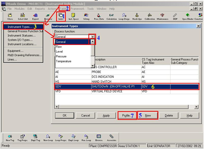

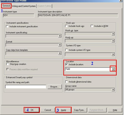

- Create SDV: click Index> Table> Instrument type> on Process function choose general> new> type like no. 6 “SDV”> P1 = Project 1 ( to differentiate with the other )
- on general tab> location, choose field & beacuse SDV as a valve not have I / O on the wiring control tab just empty it> apply> OK.

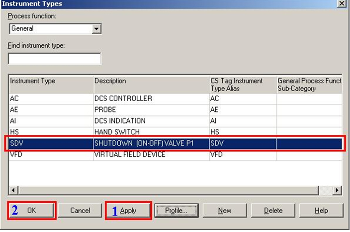

- SDV has been made> apply> OK

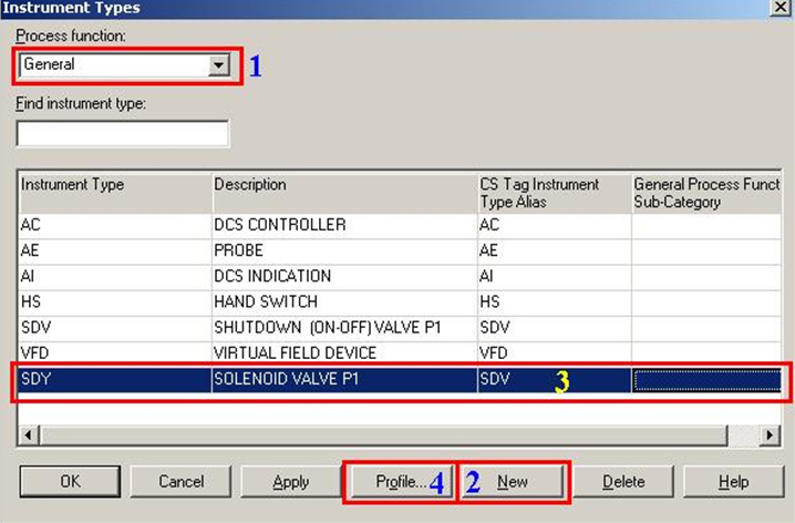

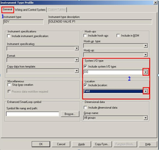

- Create SDY> Process function> General> new> type like no.3> Profile
- on the general tab> system I / O type: DO> Location field

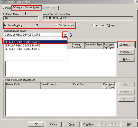

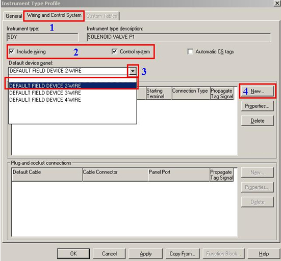

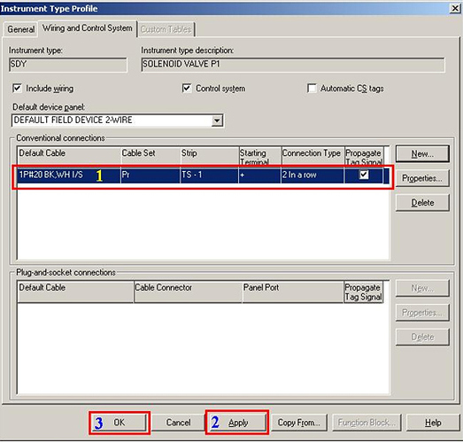

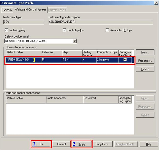

- On the Wiring & Control System tab> follow this picture:

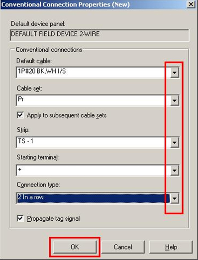

- continues with:
- wiring for SDY has been made> apply> ok
