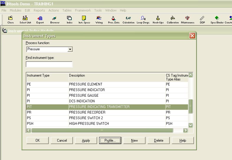

- Go to instrument type section
Open instrument index module >> Action >> Instrument Type…
- Click profile on the selected instrument type

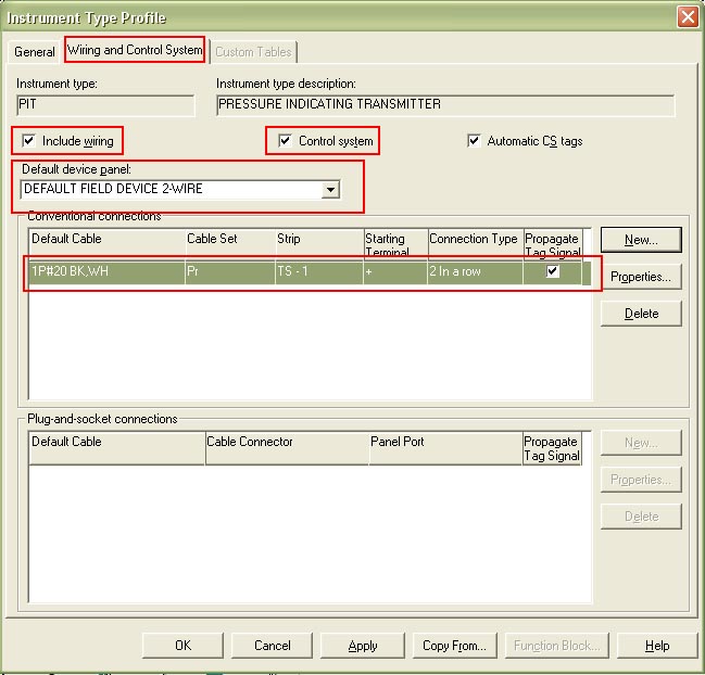

On Wiring and Control System Tab, make sure the “include wiring”, “control system” and Default device panel is properly filled

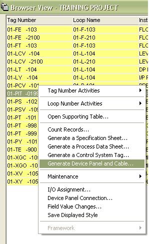

- Go to instrument index browser
Open instrument index module >> Browse >> Right click on the selected tag number >> Select Generate Device Panel and Cable
