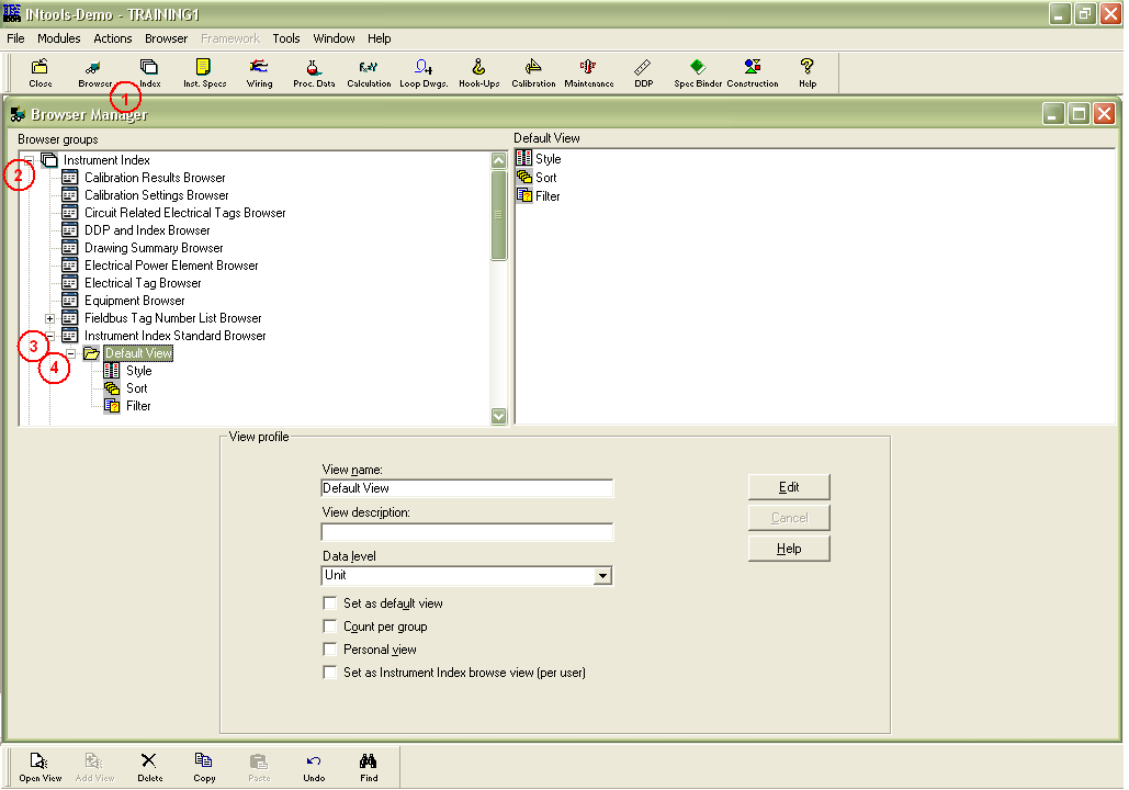

The following is the step-by-step instruction how to create/set Intools instrument index view:
Open Instrument Index Browser
Expand “Instrument Index” Folder
Expand “Instrument Index Standard Browser”
Expand “Default View”

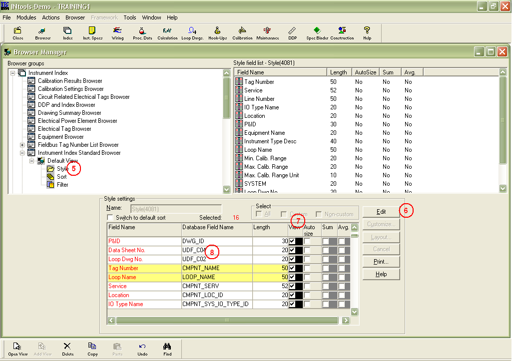

DEFAULT VIEW which has already been exist can be used…
Select “Style” under Default View
Click “Edit”
Check the box under column view for field which will be shown on instrument index view.
There are spare fields named UDF_CXX which can be used as custom field such as applicable reference document (layout drawing number, etc), remarks, etc if necessary.
Save
