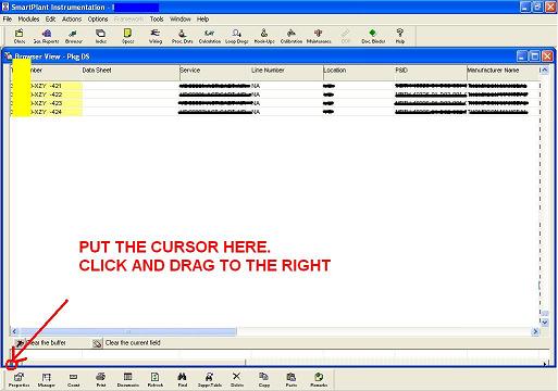

Put the cursor on the left corner of the table. Click and drag to the right as required.

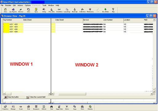

Now we have split window and filling each field is easier.
