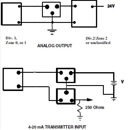

Figure below shows typical grounded and ungrounded two wire intrinsically safe circuits.
Figure below illustrates the principle that every ungrounded conductor entering the Division 1/Zone 0, or 1 location in this case where the transmitter or transducer is located, must be protected against unsafe voltage and current by appropriate associated apparatus.
The boxes with three terminals represent barriers , independently certified protective assemblies, certified and rated according to the national standard. Nonintrinsically safe devices connected to the barrier need only be suitable for their location, and must not contain voltages higher than the Um rating of the barrier.
Many barriers are passive, consisting of current limiting resistors and voltage limiting diodes in appropriate configuration and redundancy to meet the requirements of the standard. Others have active current or voltage limiting. Both types may be combined with other circuitry for regulating voltages, processing signals, etc.
The user should follow the recommendation of the intrinsically safe apparatus manufacturer in the control drawing, or discuss the selection of appropriate barriers with the barrier vendor, all of whom have proven configurations for many field mounted devices.
