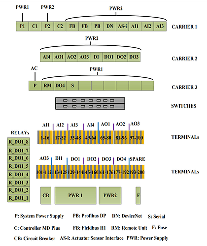

DeltaV cabinet configuration
All devices mounted inside the DeltaV cabinet are shown in Figure 3.2. They mainly include system power supplies (P1 and P2) which provide 12VDC power for controllers and other cards mounted on carriers, carriers which hold all the modules, controllers (C1 and C2), I/O cards (AI, AO, DI, and DO), switches, terminals, relays (R_DO1_1~8) and power supply (PWR1 and PWR2) for all devices in the cabinet. They are the devices at the control level.
Two power supplies, PWR1 and PWR2, convert 120VAC line power to 24VDC and provide 24VDC power to the entire DeltaV system in the cabinet. A circuit breaker (CB) is mounted before two power supplies to protect the system.
As indicated in the Figure 2, power supply number one (PWR1) supplies 24 VDC power to the system power supply P1 which converts 24VDC to 12VDC and carrier 3.
Figure 2 Device schematic diagram in DeltaV cabinet
Power supply number two (PWR2) supplies 24 VDC power to the system power supply P2 which converts 24VDC to 12VDC, other carriers, and DO intermediate circuit power through fuse F. Carriers provide power to all the cards mounted on the carriers.
The two switches have separated AC power supply. R_DO1_1~8 are relays used for connecting AC powered field devices to DeltaV DO cards which can only connect DC powered field devices.
