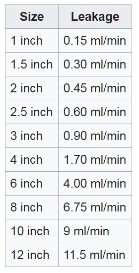

Class VI valves are slightly different in that they are required (at 50psi or operating pressure, whichever is less) to have less than a specified leakage rate in millilitres of air per minute:
