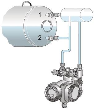

In direct methods the hydrostatic pressure of the liquid column is measured.
Indirect methods of liquid level measurements generally used in industries are:
- Hydrostatic pressure type
- Electrical methods.
Hydrostatic pressure type:
A liquid in a tank at rest exerts a force on the wall of the tank. This force in a liquid at rest is known as hydrostatic pressure. This is proportional to the depth (or height) of liquid in the tank.
Hydrostatic pressure methods used for liquid level measurement are listed below:
- Pressure gauge method
- Air Bellows
- Air Purge System (or) bubbler system
- Liquid purge system
- Diaphragm box type
- Force balance type
