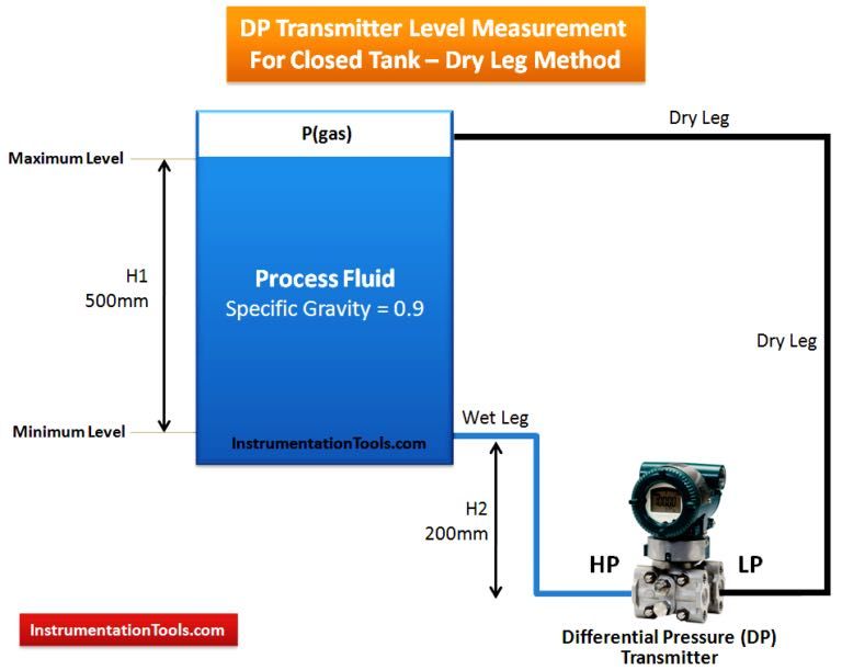

DP Transmitter Level Measurement for Closed Tank ā Dry Leg Method
Simply when LP side of the DP transmitter is filled with any gas/air then we call it as Dry Leg & we apply Dry Leg Method for calculations.
DP Transmitter Level Measurement for Closed Tank Dry leg Method
At zero level (LRV) = pressure acting on HP leg ā Pressure acting on LP leg
=H2 x specific gravity ā 0
= 200 x 0.9 ā 0
= 180 mmwc
At 100 % level (URV) = pressure acting on HP leg ā Pressure acting on LP leg
= (H2+H1) x specific gravity ā 0
= (200 + 500) x 0.9 ā 0
= 630 mmwc
Range = URV ā LRV = 630 ā 180 mmwc = 450 mmwc
So, we have to set Lower Range Value (LRV) = 180 mmwc and Upper Range Value (URV) = 630 mmwc in the DP Transmitter using HART communicator.

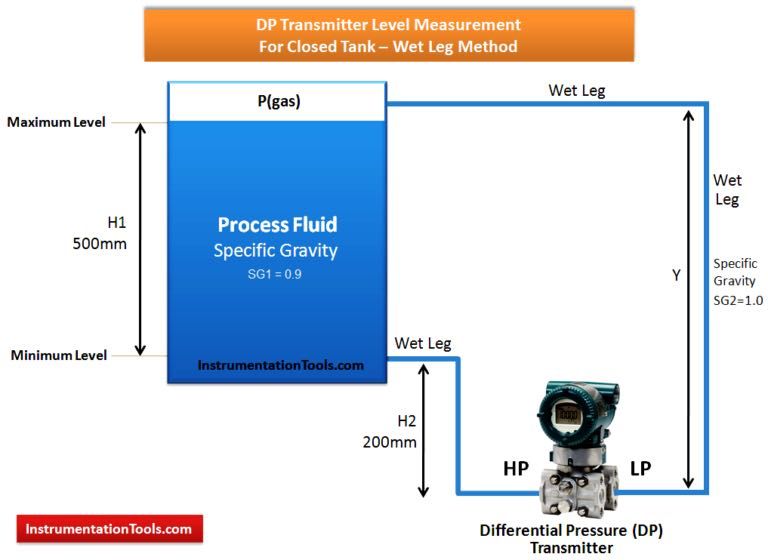

DP Transmitter Level Measurement for Closed Tank ā Wet Leg Method
Simply when LP side of the DP transmitter is filled with liquid then we call it as Wet Leg & we apply Wet Leg Method for calculations.
DP Transmitter Level Measurement for Closed Tank Wet leg Method
Y = H1 +H2 = 500 + 200 = 700 mm
= H2 x SG1 ā Y x SG2
= 200 x 0.9 ā 700 x 1.0
= 180 ā 700
= ā 520 mmwc
= (H2+H1) x SG1 ā Y x SG2
= (200 + 500) x 0.9 ā 700 x 1.0
= 630 ā 700
= -70 mmwc
Range = URV ā LRV = -70 ā (-520) = 450 mmwc
So, we have to set Lower Range Value (LRV) = -520 mmwc and Upper Range Value (URV) = -70 mmwc in the DP Transmitter using HART communicator.
