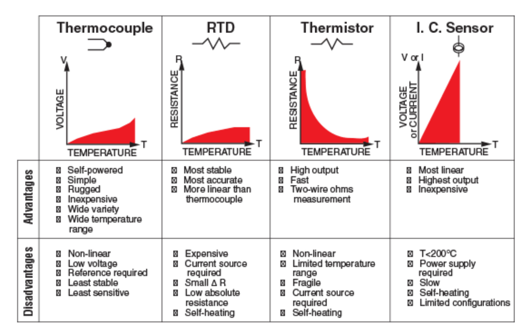

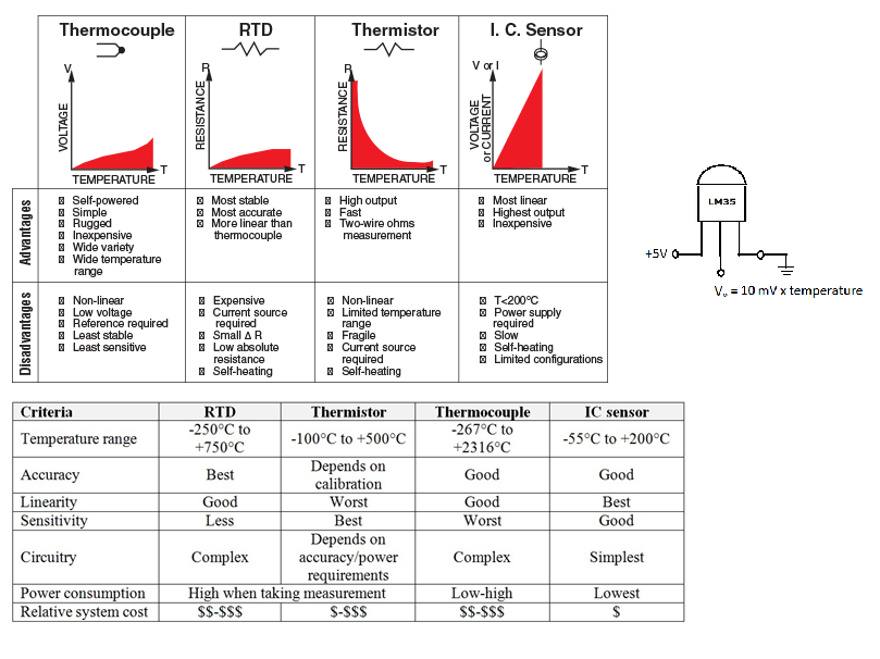

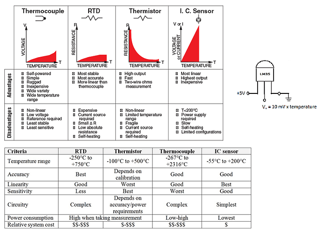

LM35 is one of the most widely used temperature sensor.
Operates at 5V , it draws less current ( 60 µA).
It is more accurate & linear than thermistor.
It produces 10mV per °C.
It doesn’t require any external calibrator & operates within -55°C to 150°C.
Operating principle:
Operating principle is similar to that of RTD, where resistance of material changes with temperature .
Advantages:
No calibration required, directly calibrated in terms of °C.
Low power consumption.
Low cost.
Easy interface with µ-contoller/processor.
Good accuracy and good resolution.
Linear.
Disadvantages:
- Low operating temperature.
Applications:
As sensor in room temperature controller.
Machine temperature sensors.
Battery temperature monitoring.
Electronic board temperature measurement.
