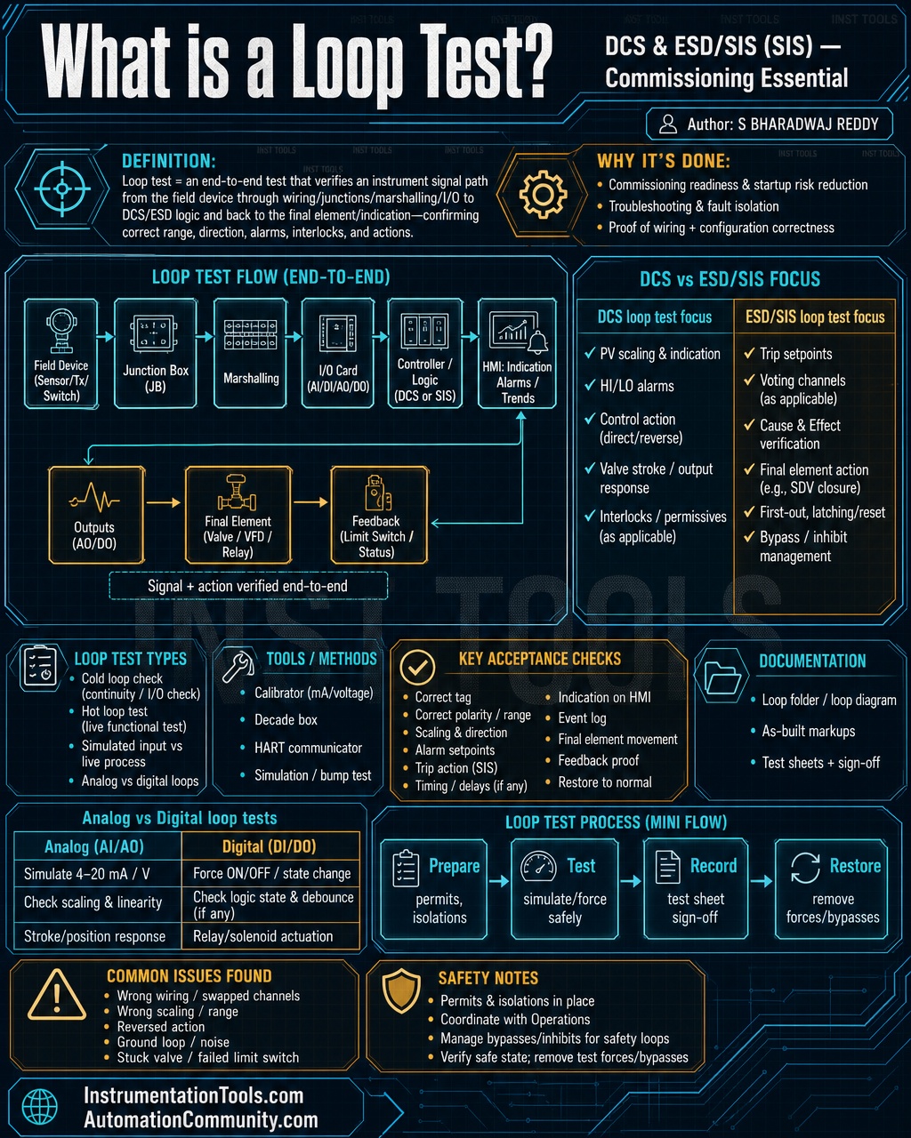

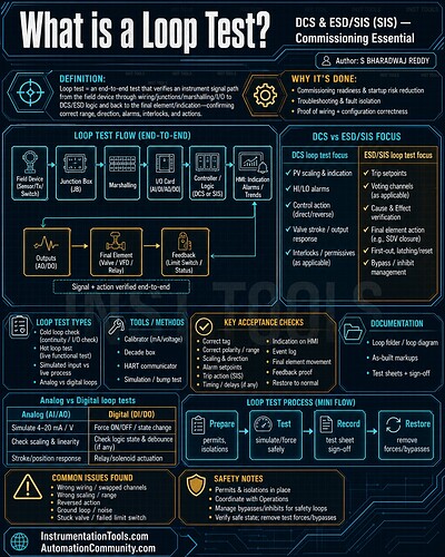

Loop test in DCS and ESD system
:counterclockwise_arrows_button::test_tube: LOOP TEST IN DCS & ESD SYSTEM: How Do You Prove a Signal Works From Field to Control Room? :factory::gear:
A transmitter may be perfectly calibrated—but that doesn’t automatically prove the complete signal path is correct.
That’s why we perform a Loop Test. :magnifying_glass_tilted_left:
:small_blue_diamond: What is a Loop Test?
A loop test is a functional test performed to verify that a complete instrumentation or control signal path works correctly from the field device to the receiving system and, where applicable, through the final control element.
In simple terms:
:electric_plug: Field → Cable → JB → Marshalling → I/O → DCS/ESD → Logic → Final Element
The objective is to confirm that the correct field signal reaches the correct destination and produces the intended response.
:desktop_computer: Loop Test in DCS
Consider a pressure transmitter connected to a DCS:
Pressure Transmitter → JB → Marshalling → AI Card → DCS
During the loop test, the field signal is simulated or generated and the DCS engineer verifies:
:satellite_antenna: Correct signal received
:label: Correct tag displayed
:chart_increasing: Correct engineering value
:bar_chart: Correct scaling
:police_car_light: Correct alarm generation
:desktop_computer: Correct DCS graphic indication
Example
Suppose a pressure transmitter has a range of:
0–10 bar
Apply a suitable test signal corresponding to:
0 bar → 4 mA
5 bar → 12 mA
10 bar → 20 mA
The DCS should display approximately:
0 → 5 → 10 bar
This verifies the signal path and configuration.
:police_car_light: Loop Test in ESD System
An ESD/SIS loop test has an additional safety-critical objective.
Example:
Pressure Transmitter → JB → Marshalling → SIS/ESD I/O → Safety Logic → Solenoid → Shutdown Valve
The test may verify:
:small_blue_diamond: Correct transmitter input
:small_blue_diamond: Correct ESD input channel
:small_blue_diamond: Correct tag association
:small_blue_diamond: Correct trip setpoint
:small_blue_diamond: Correct Cause & Effect logic
:small_blue_diamond: Correct output activation
:small_blue_diamond: Correct solenoid operation
:small_blue_diamond: Correct shutdown valve response
:small_blue_diamond: Correct feedback indication
:warning: Because ESD systems perform protective shutdown functions, testing must follow the approved test procedure, permit requirements, bypass/inhibit controls, and plant safety procedures.
:vs_button: DCS Loop Test vs ESD Loop Test
DCS ESD
Mainly process monitoring/control Safety/shutdown function
Verifies signal and control path Verifies safety function path
AI/AO/DI/DO signals Safety I/O and shutdown signals
May involve control outputs May operate shutdown devices
Focus on correct process operation Focus on correct protective action
:bullseye: Important Difference
A DCS loop test may confirm:
“The DCS receives the correct transmitter signal.”
An ESD loop test may need to demonstrate:
“The safety input produces the intended shutdown action through the safety system and final element.”
That makes ESD loop testing particularly important during commissioning, modification, and proof/testing activities. :police_car_light:
:light_bulb: Interview Question
What is the purpose of a loop test?
:backhand_index_pointing_right: To verify the complete signal path and intended functional response from the field device through the associated wiring, I/O, control/safety system, logic, and—when included in the test scope—the final control or shutdown element.
:wrench: Calibration proves the instrument is accurate.
:counterclockwise_arrows_button: Loop testing proves the system works as a complete loop.
:police_car_light: In an ESD system, that difference can be critical to plant safety.
